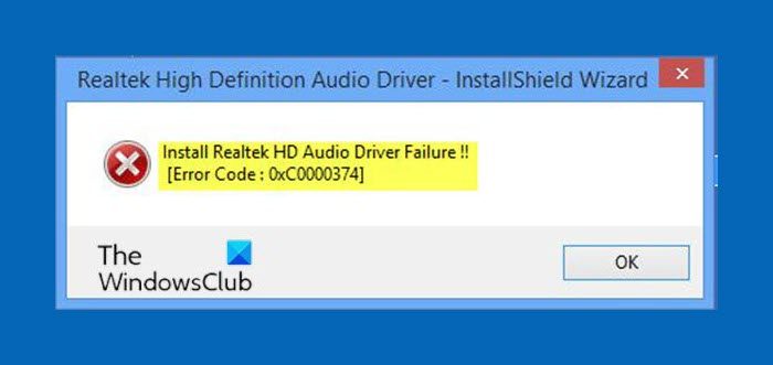

If when you try to install the necessary drivers for your Realtek sound card, and you receive the error message – Install Realtek HD Audio Driver Failure, Error 0xC0000374, then this post is intended to help you. In this post, we will attempt to identify the possible cause for the error, as well as provide the appropriate solutions you can try to help you remediate the issue.
When the driver installation fails, you’ll receive the following error message;
Install Realtek HD Audio Driver Failure !!
[Error Code : 0xC0000374]
Bear in mind that the error code might differ, but it’s another instance of the error, and the solutions presented in this post also apply.
