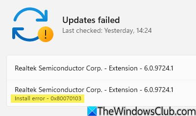

While downloading the Windows Update, many users have reported facing error code 0x80070103. If you are also facing the same problem, continue with this troubleshooting guide to get rid of the issue. When the Windows Update Error 0x80070103 occurs, it displays the following message.
Windows Update
There were some problems installing updates, but we’ll try again later. If you keep seeing this and want to search the web or contact support for information, this may help – (0x80070103).
Retry.
0x80070103 -2147024637 ERROR_NO_MORE_ITEMS, If you see Windows Update Error 80070103 when installing updates, you may be trying to install a driver that is already installed on your computer or has a worse compatibility rating than an already installed driver.
