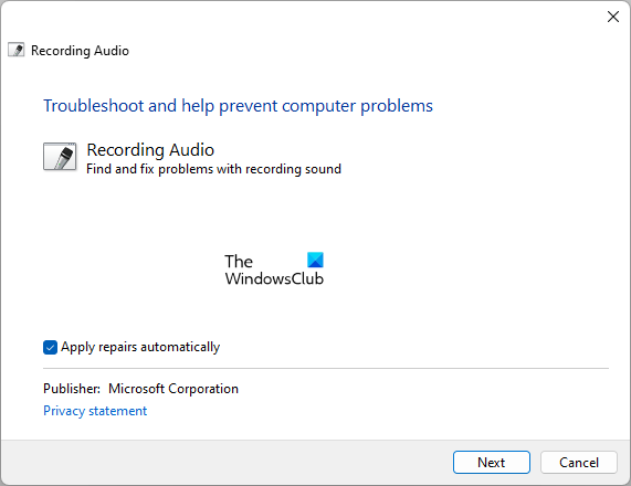

4] Run Recording Audio Troubleshooter
Run Recording Audio Troubleshooter and see if it can fix the problem.
