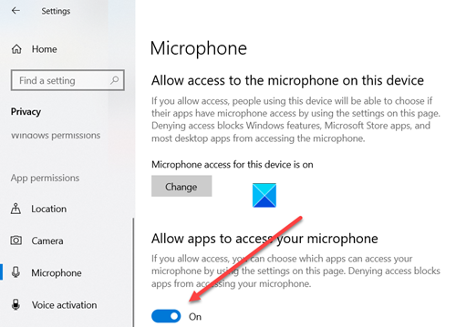

2] Allow apps to access your microphone
A new privacy setting in Windows allows you to control which apps your Microphone should have access to, by default. If the Microphone is not working for a particular app, you can change its behavior. Here’s how!
Go to Start > Settings > Privacy > Microphone.
Enabling or disabling individual settings for apps and services lets you choose which Microsoft Store apps can access your microphone.
Read: The Wizard could not start the microphone.

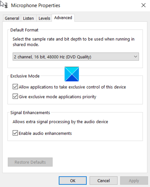

6] Disable audio enhancements
Turning off sound enhancements can fix issues that persist with the microphone.
Go to the Control Panel, click the Sounds link.
In the Sound window that opens, switch to the Recording tab.
Select the microphone you are troubleshooting, and then click Properties.
Switch to the Advanced tab.
Here, deselect Enable audio enhancements box under Signal Enhancements heading.
Hit the OK button when done.
Click OK to save your changes.
