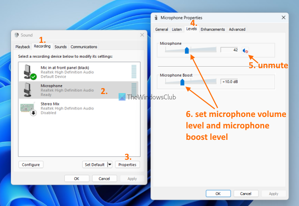

1] Check microphone mute and volume settings
Check if your internal microphone is muted or the volume is too low which makes you think it is not working or there is a problem with it. In that case, unmute it, and adjust its volume settings. For this, follow these steps:
- First of all, open Sound settings on your Windows 11/10 laptop
- In Sound settings, go to the Recordings tab
- Select your internal microphone for which you are having this issue from the recording device list present in that tab
- Click on the Properties button to open the Microphone Properties box
- In that box, go to the Levels tab
- Check if your microphone is muted. If yes, unmute it by clicking on the Volume icon
- Move the slider to increase the volume of the microphone
- Also, set the Microphone boost level to +10.0 dB or higher level
- Press the OK button to close the Microphone Properties box
- Press the OK button to close the Sound settings window.
This might work.

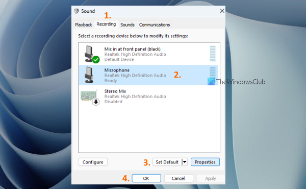

2] Set your internal microphone as the default audio device
This might be the case when you try to use your microphone with some app, it is not able to work because some other audio device is set as the default audio device. In that case, you should set your microphone as the default audio device. Here are the steps to do that:
- If you are using Windows 11 laptop, then type sound in the Search box, and press the Enter key. If you are using Windows 10 laptop, type sound in the Search box, and press Enter key to open the Sound settings. This will open the Settings app of Windows 11 with the Sound settings page. After that, scroll down that page, and click on the More sound settings option to open the Sound settings window
- Access the Recording tab in the Sound settings box
- Select the Microphone for which you want to fix the issue
- Click on the Set Default button
- Press the OK button.

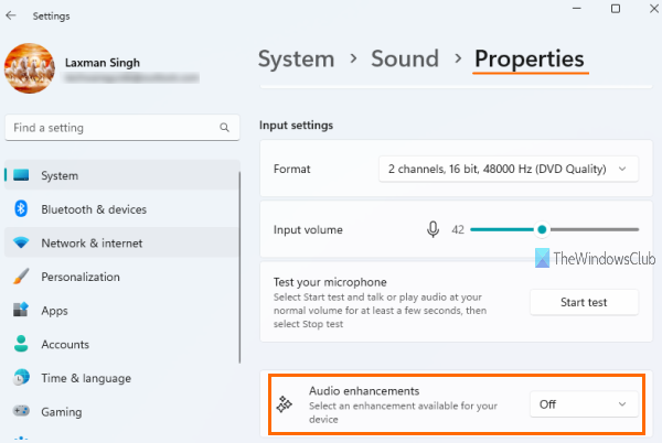

3] Disable Audio Enhancements
Sometimes, turning off or disabling the audio enhancements feature of Windows 11/10 OS fixes different microphone issues. This might be helpful in this problem also. Let’s check how to disable audio enhancements in Windows 11 and Windows 10.
Windows 11
- Use Win+I hotkey to open the Settings app. It will open with the System category
- Click on the Sound page available in the right-section of that category
- Access the Input section. There, expand the Choose a device for speaking or recording menu
- Select the microphone for which you need to fix the problem
- After selecting it, click on the right-part of that microphone to access its properties
- In the Audio enhancements option, click on the available drop-down menu
- Select the Off option.

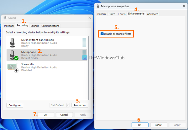

Windows 10
- Click on the Search box
- Type sound and press Enter to open the Sound settings
- Click on the internal microphone
- Click on the Properties button. This will open the Microphone Properties box
- There, go to the Enhancements tab
- Select Disable all sound effects option
- Hit the OK button to close the Microphone Properties box
- Now, press the OK button to close the Sound settings window.

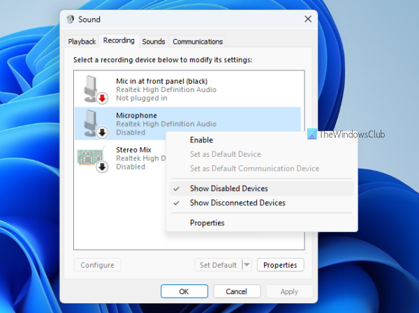

4] Check your internal microphone status
There is a chance that your Windows 11/10 laptop is unable to recognize your microphone because it is either disabled or disconnected. So, if this is the case, then the steps to resolve this issue are:
- Open Run Command box using Win+R hotkey
- Type
mmsys.cplin the text field - Hit the Enter key to open the Sound settings window
- Switch to the Recording tab
- In an empty area under the Recording tab, right-click, and select the Show Disabled Devices option and the Show Disconnected Devices option
- Now your microphone should appear in the list. After that, you may see an encircled down arrow for your microphone which means the microphone is disabled. To enable it, right-click on it, and select the Enable option. Now, it should show a green tick mark that indicates that the microphone is enabled
- Finally, test the microphone by speaking to it. If there are green bars visible in the stack available just next to your microphone, that means it is working now
Your problem should be gone now.
