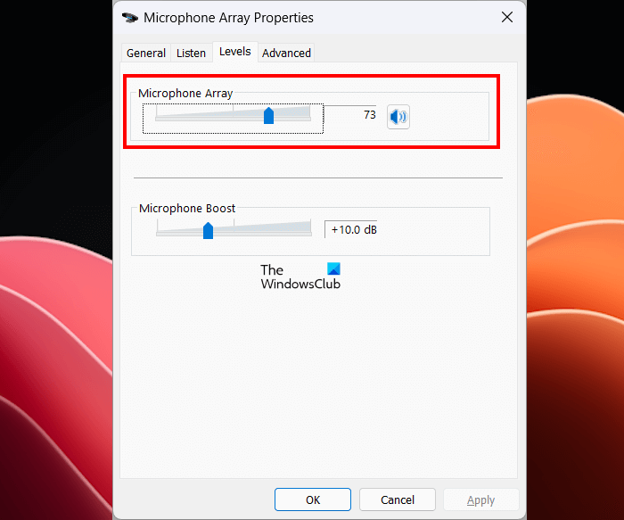

2] Adjust your microphone volume
If your microphone volume is too high, it can cause the microphone sound to be distorted. This can be the case with you. We suggest lowering your microphone volume and seeing if it helps. The following steps will help you with that:
- Open the Control Panel.
- Type Sound in the Control Panel search box.
- Click Sound in the search results.
- The Sound properties window will appear. Go to the Recording tab.
- Select your microphone and click Properties.
- Go to the Levels tab and move the Microphone Array slider to the left.
Now, check if the issue occurs.

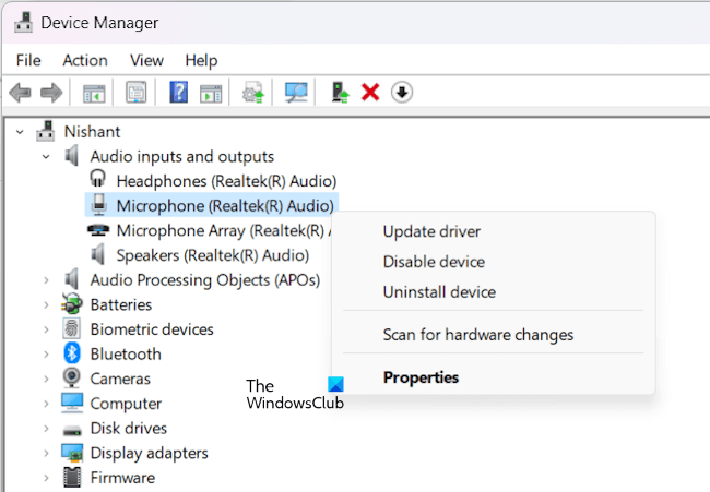

6] Reinstall your microphone driver
One possible cause of this problem is the corrupted microphone driver. Update or reinstall your microphone driver. Go through the following instructions:
- Open the Device Manager.
- Expand the Audio inputs and outputs branch.
- Right-click on your microphone driver and select Uninstall device.
- Restart your computer or perform a scan for hardware changes to reinstall the microphone driver.

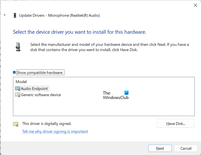

7] Install another version of your microphone driver
If you still hear the clicking sound or popping noise from the microphone, installing another version of its driver can help. Before you proceed, we recommend you create a System Restore Point, so you can restore your system if a problem persists.
The following instructions will guide you on this:
- Right-click on your microphone driver and select Update driver.
- Select Browse my computer for drivers.
- Now, select Let me pick from a list of available drivers on my computer.
- Make sure that the Show compatible hardware checkbox is selected.
- Select a driver from the list.
- Click Next and follow the on-screen instructions to install the selected driver.
If this does not work, install another compatible driver by following the above steps.
