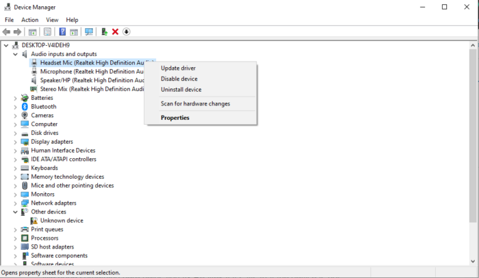

3] Update, or reinstall audio drivers
Updating your Audio drivers can fix Realtek if it says a device is not supported on your PC. Updated drivers fix outdated, incompatible, and corrupted drivers. If the audio driver is updated, you may reinstall it and see if the issue is fixed. You can get the drivers from the manufacturer’s website and reinstall them manually. Many users have reported fixing unsupported audio devices by updating or reinstalling their drivers.
