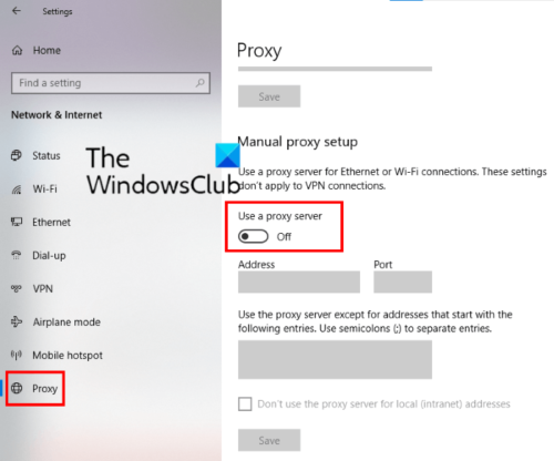

3] Uninstall VPN client or disable Proxy server (if applicable)
This is a known fix for most connection issues on Windows PC – it requires that you try uninstall your VPN software or reset Proxy Settings or disable/remove any proxy server from your computer. A VPN/GPN or Proxy can cause interference issues with the servers, but if already disabled it might be worth trying to connect via VPN to see if that sorts out the connection issue.

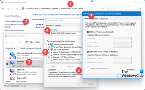

4] Change Local DNS to Google DNS
This solution simply requires you to change to Google Public DNS. If the DNS settings are corrupted, it can prevent certain applications from making contact with the internet – you can reset, release & renew IP, Winsock, Proxy, DNS on your PC and see if that helps. Otherwise try the next solution.

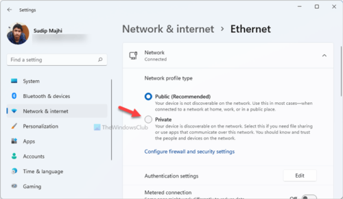

5] Change Network Profile
This solution requires you to change your Network Profile (if the option is missing, see Option to change Network from Public to Private missing in Windows 11/10) from Public to Private or vice-versa and see what works. If the issue persists, try the next solution.

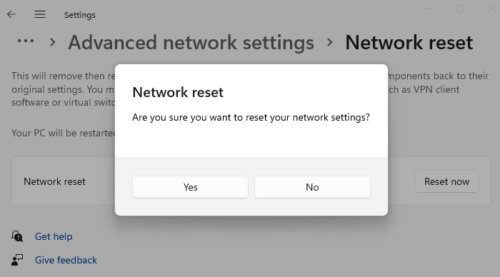

6] Reset Network
You may be experiencing the issue in hand due to slow internet connection, dropped connection, lost or no connection of wireless or wired (ethernet) network on your Windows 11/10 computer system. In this case, to resolve the issue, you can reset Network Adapters using the Network Reset feature.
