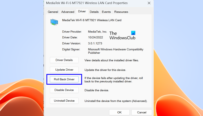

3] Roll Back your Network card driver
You can install the previous version of your Network card driver by using the Roll Back option. Check if the Roll Back Driver option is available for your Network driver. Go through the following instructions:
- Open the Device Manager.
- Expand the Network adapters branch.
- Double-click on your network card driver to open its properties.
- Go to the Driver tab and click on the Roll Back button (if it is clickable).
- Follow the on-screen instructions to install its previous version.

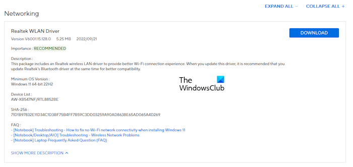

A corrupt Network card driver is the main cause of this issue. We suggest you update or reinstall your Network card driver. To reinstall the driver, right-click on the Network card driver in the Device Manager and select Uninstall device. After doing that, restart your laptop or scan for hardware changes.
You can update your Network card driver to the latest version by downloading its most recent version from the official website of your computer manufacturer. After downloading the driver, install it manually.

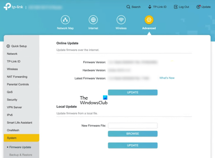

6] Update your Router firmware (if applicable)
You can also check for updates for your router firmware. If an update is available, install it. This fix is not applicable to all routers because the firmware update option is not available in some routers. You have to log in to your administrator account of your router and then check if the firmware update option is available there. If yes, install the firmware update. Alternatively, you can also contact your router support to get more information about firmware updates.
