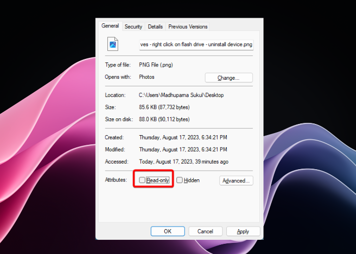

It could also be possible that your USB drive is write-protected since it’s locked. So, check the drive and ensure that the lock switch is in the correct position. You may also check if your files and folders are in Read-only mode. In this case, remove the USB stick and disable the read-only mode for the files you want to copy. Besides, ensure the USB controller drivers are updated to the latest version, and run a virus scan to check that it’s not infected.

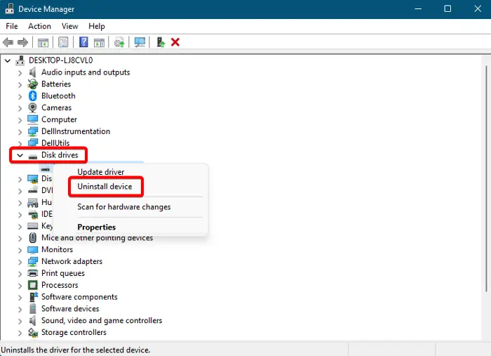

6] Reinstall USB controllers
If none of the above methods work, you can try uninstalling and then reinstalling the USB flash drive. For this, remove the flash drive, open Device Manager, click on View at the top, and select Show hidden device. Now, expand the Disk drives section, right-click on the flash drive, and select Uninstall device. In the Uninstall Device prompt, press Uninstall again to confirm. Once done, reconnect the USB drive, and it will be installed again automatically.
