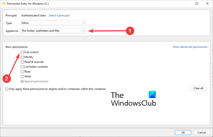

First, open File Explorer using Win+E and locate the drive that contains your files and folders with which you are experiencing this issue. Now, right-click on the drive and select the Properties option from the appeared context menu.
In the newly opened window, move to the Security tab and press the Advanced button located at the botton of the window.
Next, click on the Change permissions button, then highlight your user and press the Edit button.
After that, click on the Applies to: drop-menu button and select the This folder, subfolders and files option. And then, tick the Full control checkbox present under Basic permissions and tap on the OK button. Hopefully, you won’t face the same issue now.

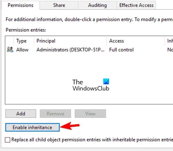

If there are multiple users on your system, you can follow the steps below to change your drive permissions:
Firstly, move to the system drive and double-click on the Users folder to open it. You will see a folder with your username; just right-click on that folder and click on the Properties option from the right-click context menu.
Inside the Properties window, navigate to the Security tab and press the Advanced button. After that, press the Enable inheritance button and click on the Apply > OK button to save changes.
