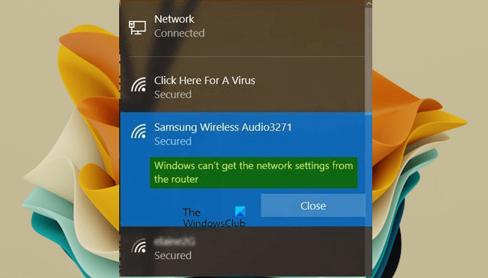

If you receive a message Windows can’t get the Network Settings from the router when using the Printer, Wi-Fi, Mobile Hotspot, WiFi Speakers, etc, on your Windows 11/10 computer, perhaps something here will help you fix the problem.
To fix the Windows can’t get the Network Settings from the router error on your Windows 11/10 computer, use the following fixes:

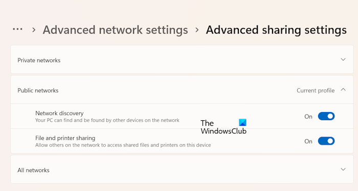

7] Turn on Network Discovery
In Windows 10, open Control Panel > Network and Sharing > Change advanced sharing settings. Here select Turn on network discovery and also Turn on file and printer sharing and see if it helps.
If you are a Windows 11 user, follow the steps provided below to turn on Network Discovery:
- Open Windows 11 Settings.
- Go to Network & internet > Advanced network settings.
- Select Advanced sharing settings.
- Turn on the following options for Private or Public networks (depending on your preference)
- Network discovery
- File and printer sharing
Check if the issue persists.
