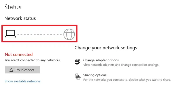

1] Check Ethernet cable connection
It is one of the basic steps we ask when you cannot connect to the internet or when the Ethernet is showing you limited connectivity. Earlier Windows used to replace the connectivity icon in the system tray with a clear message that the ethernet cable is not connected. The same applied to Wifi. Now all you get to see a globe icon which says “Not connected – No connections are available“.
It’s confusing, so check if the Ethernet cable is connected correctly. If it’s connected to the router, make sure the router is turned on. An alternate way is to go to Control Panel\All Control Panel Items\Network Connections and check if any of the Ethernet statuses says — Network cable unplugged.
If that’s connected, follow the next step.

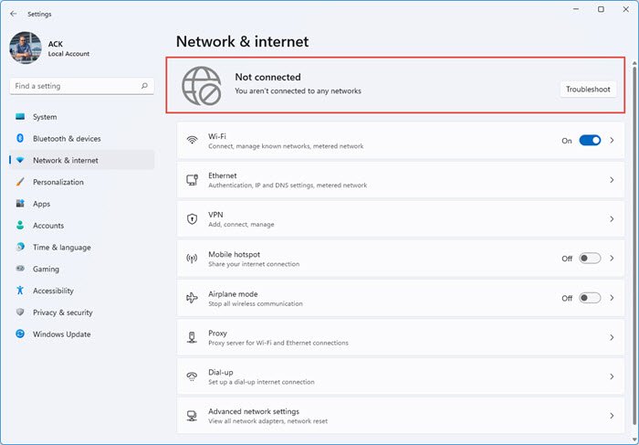

2] Enable Ethernet in Windows to fix the problem
The same globe icon is displayed when the Ethernet connection is disabled in Windows 111/0. When I say disable, I mean that the device is disabled on the software level. Here is how to enable it
- Open Settings (Win + I) and navigate to Network and Internet
- Click on Change adapter options button
- It will reveal the list of Ethernet connections available on the computer
- Check if any of the Ethernet is greyed out. If yes it is disabled.
- Right-click on it, and click on Enable.
It will restore the working status. If it’s enabled, and Ethernet is still not working and displays the Globe icon, we need to check if the Internet is working.

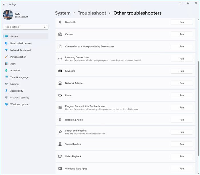

6] Use Network Troubleshooter
The Network troubleshooter is an inbuilt solution that can fix small and medium issues on its own.
Windows 11
Open Windows 11 Settings > System > Troubleshoot > Other TRoubleshooter and run the Network Adapter Troubleshooter.
Windows 10
- Open Settings, and navigate to Update & Security > Troubleshoot > Network Adapter
- Select, and click on Run the troubleshooter button
If the problem is basic, it should be able to fix it.
