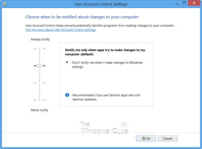

4] Change UAC level
Due to security setting of newer versions of Windows, certain file types that are opened through Store apps will require UAC (User Account Control) permissions in order to run, but since the built-in account doesn’t have UAC privileges, you’ll get the error. In this case, to resolve the issue, you can change the UAC level on your Windows 11/10 PC.
Try the next solution if this didn’t work for you.

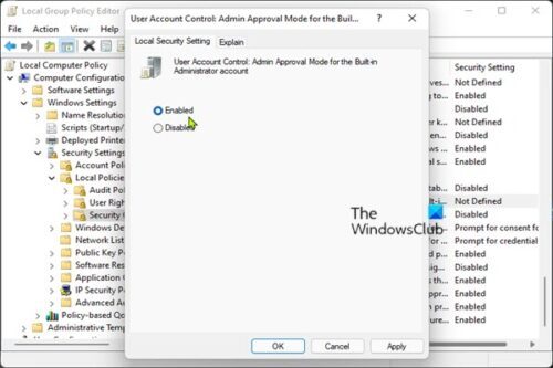

5] Modify User Account Control policy via Group Policy Editor
This is a two-step solution which requires you to enable Admin Approval Mode for the Built-in Administrator Account and then modify the User Interface Privilege Isolation (UIPI) registry key value.
Do the following:
- In the Run dialog box type gpedit.msc and hit Enter to open Group Policy Editor.
- Inside the Local Group Policy Editor, use the left pane to navigate to the path below:
Computer Configuration > Windows Settings > Security Settings > Local Policy > Security Options
- Scroll on the right pane, locate and double-click on User Account Control: Admin Approval Mode for the Built-in Administrator account policy to edit its properties.
- In the policy window, set the radio button to Enabled.
- Click Apply > OK to save the changes.
- Exit Group Policy Editor.
For Windows 11/10 Home users, you can add Local Group Policy Editor feature and then carry out the instructions as provided above.

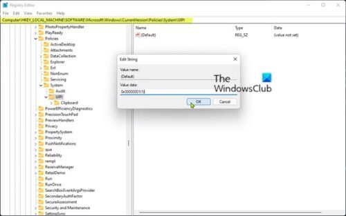

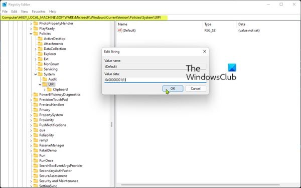

Now, you can proceed with the step 2 to modify the UIPI registry key value.
Computer\HKEY_LOCAL_MACHINE\SOFTWARE\Microsoft\Windows\CurrentVersion\Policies\System\UIPI
- At the location on the right pane, double-click on the (Default) entry to edit its properties.
- In the properties dialog, input 0x00000001(1) in the Value data field.
- Click OK or hit Enter to save the change.
- Exit Registry Editor.
- Restart PC.
