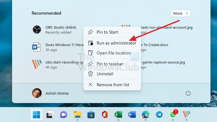

1] Use the Run As Administrator Option
If you need to run a program with administrator rights, you can use the “Run As Administrator” option. To do this, right-click on the program’s icon and select Run As Administrator. You will then be prompted to enter the administrator password. Once you do so, the program will run with administrator rights.
While it is the easiest way, it also means users will need to know the admin account’s PIN or password. It will not be ideal most of the time unless the admin can trust the users enough so they don’t misuse it.

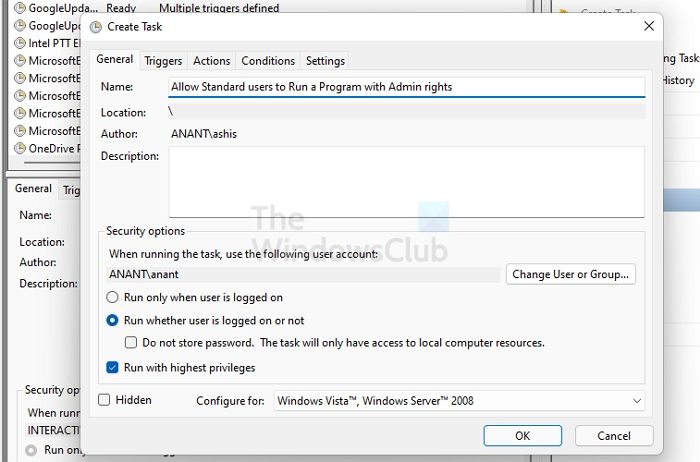

2] Use the Task Scheduler
If you need to run a program in the background or at a certain time for a standard user with admin rights, then follow these steps:
- First, the user must open the Task Scheduler by going to the Start Menu and searching for Task Scheduler.
- Once in the Task Scheduler, the user should click Create Task in the right-hand pane.
- A new window will open titled Create Task. Here name the task and set it to run whether the user is logged on or not. They should also check the Run with the highest privileges box.
- Click on Change User or Group and select the user account you want to run the task.
- Under the Triggers tab, the user should click New and set the task to run at a certain time or interval.
- Make sure to fill in the remaining details so the task runs as expected.
It should be created by admin users and allow us to run it in the standard user account.
