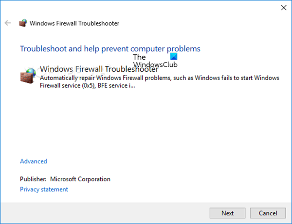

1] Run Windows Firewall Troubleshooter
To begin troubleshooting the Security or Firewall might be blocking the connection issue on your Windows 11/10 computer, you can run the Windows Firewall Troubleshooter and see if that helps. The Windows Firewall Troubleshooter is a diagcab file and the official Firewall troubleshooter from Microsoft. When you run the troubleshooter, you’ll be taken through step-by-step as the app looks for problems. If a problem is found, it will be explained, and you can choose to repair or exit. To run the troubleshooter, follow these steps:
- Download the diagcab file.
- Once downloaded, double-click the file to run it or open the wizard.
- Follow the steps in the Windows Firewall Troubleshooter.
The automated troubleshooter fixes:
- Windows Firewall isn’t the default firewall.
- Windows Firewall doesn’t start.
- Windows couldn’t start Windows Firewall (Service-specific error 5 (0x5)).
- Remote Assistance isn’t working because it’s blocked by Windows Firewall.
- You’re unable to access shared files and printers because sharing is blocked by Windows Firewall.
- BFE service is missing.
- Firewall won’t start (Error Code 80070424).
If you’re not on the computer that has the problem, save the troubleshooter to a flash drive, and then run it on the computer that has the problem.
Read: Windows firewall can’t change some of your settings Error code 0x8007042c

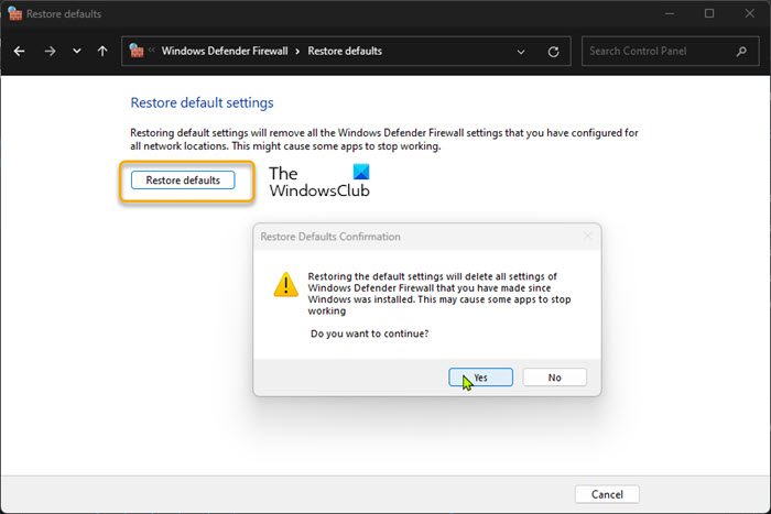

2] Restore or Reset the Windows Firewall to default settings
If your Windows 11/10 computer is blocking connections as it is in this case, the Windows Firewall may be preventing the connections from getting through. The first thing you should do if you suspect a firewall problem is to restart your computer and your network/internet device (including your DSL or cable modem). If the issue persists, you can test to see if the problem is the Windows Firewall by temporarily turning off the Windows Firewall to see if it’s causing the problem. After you test the connection, turn on the Windows Firewall to make sure your computer is protected.
If this test solved the problem, that means that Windows Firewall is blocking the connections. If so, it may help to restore or reset the Windows Firewall to default settings and then restart your PC and see if that helps. This is only the case if you have added custom firewall rules to allow certain programs that would have normally been blocked, which is rare. If you have added custom rules, you may not want to perform this task. During this process which will remove any erroneous firewall rules that are blocking legitimate connections, Windows will notify you that restoring the default firewall settings may cause some programs to stop working. To reset the Windows Firewall, follow these steps:
- Press the Windows key + R to invoke the Run dialog.
- In the Run dialog box, type control and hit Enter to open Control Panel.
- Click Windows Defender Firewall.
If the Control Panel opens in the Category view, click System and Security then click on Windows Defender Firewall.
- In the Windows Defender Firewall settings page that opens, click the Restore defaults link on the left navigation pane.
- In the Restore default settings page, click the Restore defaults button.
- Click Yes. on the confirmation prompt that appears to continue.
- Exit Control Panel when done.
Read: Import, Export, Repair, Restore Default Firewall Policy in Windows

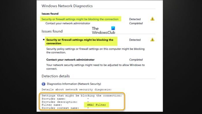

3] Temporarily disable third-party security software (if applicable)
On your Windows 11/10 computer, outgoing/incoming connections can be affected by the presence of a firewall or antivirus software (especially from third-party vendors) on the local computer or network connection. As you can see in this our case, the Windows Network Diagnostics identified the Malwarebytes Web Access Controller (MWAC) Filter which is what Malwarebytes uses for the Web Protection component in Malwarebytes (bad website blocking) that relies on the Windows Filtering Platform (WFP) APIs in modern versions of Microsoft Windows which is the same infrastructure/APIs used for the built-in Windows Firewall in newer versions of the Windows OS. Disabling the Web Protection component in MBAM worked for affected users, although this is more of a workaround than an actual solution.
So, you can disable the third-party security software. To do this, you can check the software settings page or consult the user manual. Generally, to disable your security software, locate its icon in the notification area or system tray on the taskbar, right-click the icon and choose the option to disable the program. However, if you do not have third-party security software or dedicated firewall software running on your computer, you can disable Windows Defender Firewall and see if that solves the problem. If it does, you can install and configure any reputable firewall software if that’s an option for you or see if other solutions presented in this post is more preferable and works for you.
