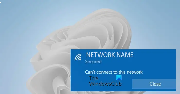

Several issues come up on Windows 11/10 computers, and one of the most frustrating ones is that Windows can’t connect to this network error. This error appears with no obvious indication of what’s causing it or how to fix it, making it tough to debug for many people. And we all know how vital our computer’s network connection is. So, if you’ve tried connecting your Windows PC to the network but it’s not working, we’ve got you covered. Most of the time, if Windows was unable to connect to WiFi the cause of this problem can be traced to a few factors, which we’ll go over in this post, along with the best ways to fix Windows that can’t connect to this network error.
What should you know about Windows can’t connect to this network error?
When users try to connect to the internet, the Can’t click to this network message appears. Regardless of which choice you make, the problem will at times render the internet inaccessible to you. In addition, the problem is most often caused by incorrect network settings on your computer, and it could also be caused by a faulty network source or a problem with your network drivers.
However, using the approaches we’ll discuss in this article, it’s still something that can be fixed. But, before we get into that, here are the most likely causes of the error:
