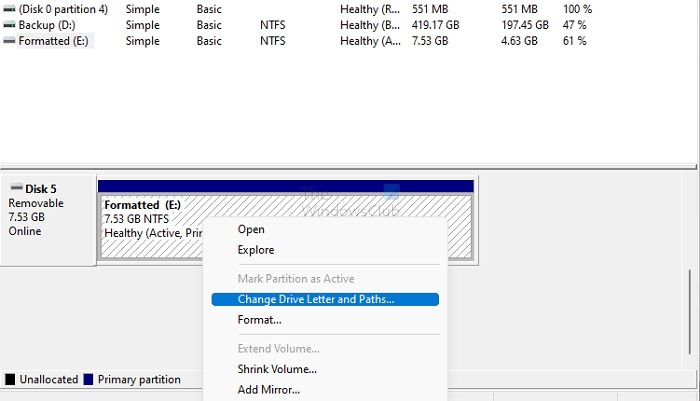

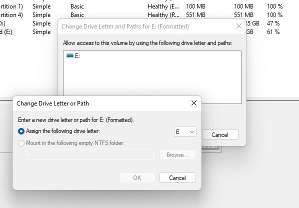

3] Change Drive Letter
Some user face unwanted errors like their USB is detected but not showing in Windows explorer, and due to this error, they can’t even open their files stored on the USB. In such a situation, changing the drive letter fix works amazingly. Here is a detailed guide on this process.
- You can open disk management in Windows by right-clicking the Windows Start menu and selecting Disk management.
- You must select the required partition in Disk Management to change the drive letter. Now right-click it and choose Change drive letter and path.
- Now click on Add to add a new drive letter and click OK. You can easily use this process to add drive letters for all required partitions.
- After adding the new drive letter, you can check if the USB drive is regular or shows the same error again.

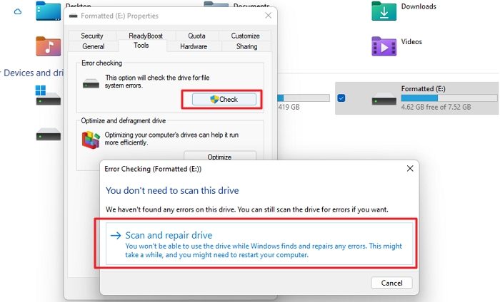

1] Error Checking Tool in Windows
It is a built-in tool that comes with the Windows operating system. This tool can quickly check for any driver error. In addition, this tool can automatically fix file system errors. The scan for and attempt recovery of bad sectors feature of this inbuilt tool also performs a complete scan of drive which may bed damaged or unusable.

3] The command-line CHKDSK Tool
Before going for any third-party tool, we will always recommend you check whether your USB drive can be detected by your Windows PC or not. CHKDSK utility tool within the command prompt is another built-in tool on Windows that can quickly detect USB drive errors. This tool can easily detect the bad sectors and fix casual disk errors. Follow our detailed guide on how to use this ChkDsk tool.
- Open File Explorer and go to This PC. Note the driver letter for the USB Drive.
- Open Windows Terminal or Command Prompt with Admin permission
- Type the following command and let the process complete
chkdsk <usb-drive-letter> /f /r
The options /f and / r will scan the integrity of the file system and file system metadata. It will also fix any logical file system errors on the USB drive.
Once done, eject the USB drive, and reinsert it to check if the issue is resolved.
