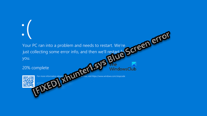

There have been reported cases by some PC users encountering the DRIVER_IRQL_NOT_LESS_OR_EQUAL or PAGE_FAULT_IN_NONPAGED_AREA Blue Screen error with the Xhunter1.sys file identified as the culprit on their Windows computer. Xhunter1.sys is a third-party driver file used by the XIGNCODE3 System Guard anti-cheat engine.
Affected PC users reported the error occurring in different instances. One such report stated the error occurs when trying to log into a game after instantly closing the game or after some work in other applications. Other reports stated the BSOD error occurs when a particular game (e.g., Blade and Soul, PUBG) is started or while playing the game on the computer. In any case, this post offers solutions to this error.
Fix Xhunter1.sys Blue Screen error
If you have encountered the xhunter1.sys BSOD error while performing certain tasks or launching or playing specific games on your Windows 11/10 PC, our recommended solutions, presented below in no particular order, if applied correctly, should help you resolve the issue on your system.
