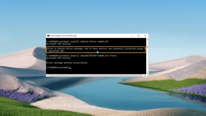

When you try to delete or uninstall a device driver on Windows 11 or Windows 10 computer using the PnPUtil driver manager utility, you may get the error Failed to delete driver package stating One or more devices are presently installed using the specified INF. In this post, we describe the methods to accomplish this task without issues.
You’ll get either of the following full message when you’re unable to delete the driver;
- Failed to delete driver package: One or more devices are presently installed using the specified INF.
- Deleting the driver package failed: One or more devices are presently installed using the specified INF.

PnPUtil Failed to delete the driver package
If you get the PnPUtil error Failed to delete driver package when you attempt to delete or uninstall a particular device driver on your Windows 11/10 computer, you can use any of the methods listed below to successfully perform the task.
