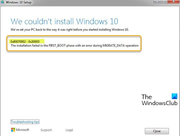

If when you attempt to perform Windows 11/10 upgrade install, and you encounter the error 0x80070002 – 0x3000D, then this post is intended to help you. In this post, we will provide the most suitable solutions you can try to successfully resolve this issue.
When you encounter this issue, you’ll receive the following full error message;
We couldn’t install Windows
We’ve set your PC back to the way it was right before you started installing Windows.
The installation failed in the FIRST_BOOT phase with an error during MIGRATE_DATA operation.
Fix Windows Upgrade error 0x80070002 – 0x3000D
If you’re faced with this issue, you can try our recommended solutions below in no particular order and see if that helps to resolve the issue.
