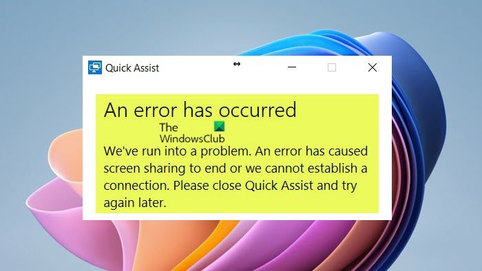

You may get the Error Code 1002 or receive the message An error has occurred when you launch Quick Assist in Windows 11/10 PC or once the security code is entered to establish the remote connection between the devices. This post is intended to help you with solutions you can apply to fix this error.
We’ve run into a problem. An error has caused screen sharing to end or we cannot establish a connection. Please close Quick Assist and try again later.
Fix Quick Assist Error Code 1002 OR An error has occurred
If you see the message “An error has occurred” or you get the error code 1002 when you launch Quick Assist on a Windows 11/10 device or after entering the security code into the app, our recommended fixes, presented below in no particular order, can help resolve the issue in both cases.

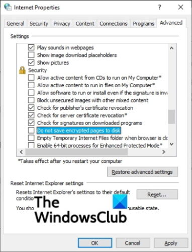

3] Change Internet Options settings
It’s possible that your computer’s Internet Options are not set properly. Specifically, encrypted pages are saved to your hard drive or SSD by default – if this setting is disabled, then you’re likely to get the error. In this case, you can simply reset Internet Options to default settings on your device or make sure that your computer is allowed to save encrypted pages by following these steps:
- Invoke the Run dialog box and type inetcpl.cpl and hit Enter to open Internet Properties.
- Select the Advanced tab,
- Under Settings, scroll down to the Security section.
- Now, uncheck the Do not save encrypted pages to disk option.
- Click on Apply > OK.

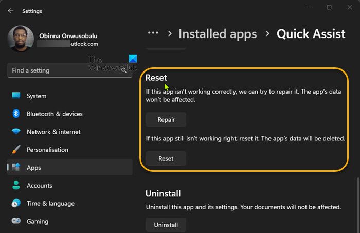

5] Repair/Reset/Reinstall Quick Assist app
If re-registering Windows Store apps doesn’t fix the app issues you’re having on your PC, then you can repair or reset the app in question by following these steps:
- Press the Windows + I key to launch the Settings app.
- In the Settings app, select Apps from the left pane.
- Click on the Apps & features tab (Windows 10) OR the Installed apps tab (Windows 11) on the right side.
- On the list of all installed apps, locate the Quick Assist app.
- Next, click on the ellipsis (three vertical lines).
- Now, select Advanced options.
- Now, scroll down the page to the Reset section. The options to Repair and Reset the app are available in this section.
- Click on the desired button.
- Exit the Settings app when done.
If both operations weren’t helpful, then you can uninstall the pre-installed (default) app and reinstall the app via Microsoft Store.
