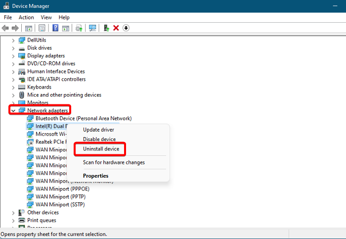

2] Reinstall the Network driver
If rolling back the network driver does not help fix the issue, you can uninstall and install the driver again. This can help you fix any incorrect or corrupt settings that may be the reason behind the BSOD error.
For this, open the Device Manager > expand Network adapters > right-click on the adapter > Uninstall device.
Press Uninstall again to confirm the action.
Now, restart your PC and the latest driver should be automatically installed. If it does not, visit the manufacturer’s website and download & install the latest version of the driver manually.
