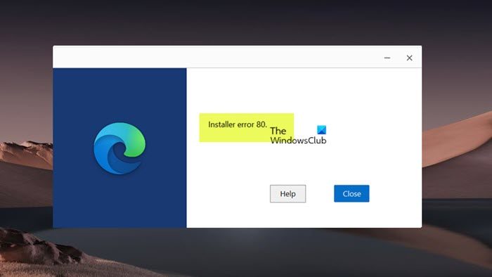

When you try to install the Microsoft Edge browser on your Windows 11 or Windows 10 computer and get the Installer error 80, this post is intended to help you with the most applicable solutions to resolve the issue on your system.
Fix Edge Installer error 80
If you’re having problems downloading, installing, or updating Edge browser on your Windows 11/10 PC and you see the Installer error 80, then our recommended solutions as presented below in no particular order should help you fix this error on your device which happens to be one of the numerous Microsoft Edge Installation & Update error codes you may encounter.

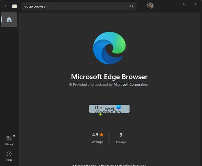

2] Download and install Edge from another source
If you try installing Edge via the official website and get the Installer error 80, you can try downloading Edge from the Microsoft Store and see if the browser installs successfully on your device.
