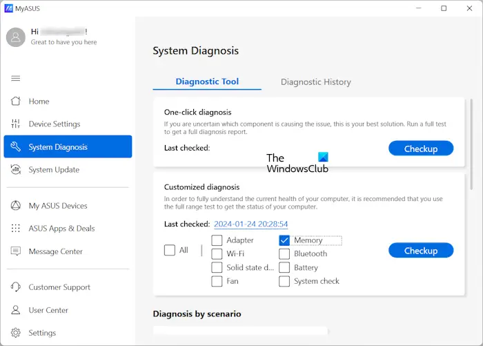

8] Run a Memory Diagnostic Test
A bad or dying memory also causes various issues, especially crashing issues. We suggest you run a memory diagnostic test. This will let you know whether your RAM is functioning properly or not.
You can use the built-in Memory Diagnostic Tool to test your RAM or the dedicated software developed by your computer manufacturer (if available).
For example, the MyASUS app can perform different types of tests on an ASUS computer, like battery adapter test, memory test, Bluetooth test, etc.
