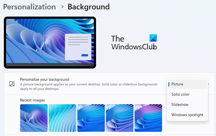

2] Check Solid color
This issue is sometimes caused by the changes made in the Desktop Background settings. For instance, you might have mistakenly selected the Solid color option on these settings. Check if you have by chance set a solid black color for your background.
Open Windows 11 Settings > Personalization. You will see the setting here. Select your favorite picture and make it your Desktop wallpaper.

4] Switch Desktop Background Type
- Open Windows Settings > Personalization
- Select Background
- Under Personalize your background, switch from your existing option to another, and see if that helps.
