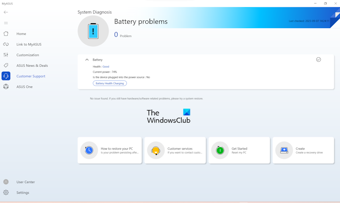

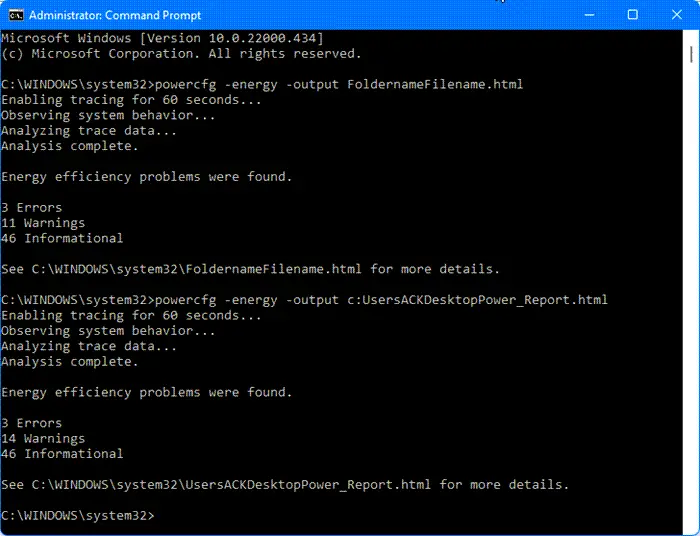

2] Check your battery health
It is possible that your laptop’s battery is not working properly. In this case, check your battery health. You can generate a Battery health report with the Power Efficiency Diagnostic Report Tool. This will help you determine whether your laptop battery is working fine or not.
You can also install free battery test software.
Many computer manufacturing brands provide dedicated software. These tools or software help users keep their systems healthy by installing the required updates. Based on your laptop manufacturer, you can also run a battery health checkup with the help of any of these tools:

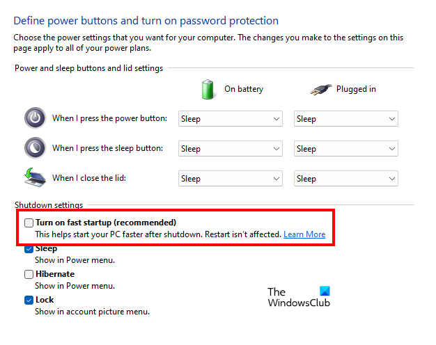

3] Disable Fast Startup
Sometimes Fast Startup can create this problem. Disabling the Fast Startup from the Control Panel can fix this issue. Use the below steps:
- Open the Control Panel.
- Click on the Power Options.
- Click on Choose what power button does and then on Change settings that are currently unavailable.
- Now, uncheck Turn on fast startup (recommended).
- Click on Save changes.

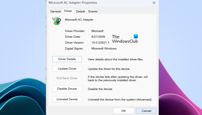

5] Roll back your battery driver
You can try to roll back your battery driver. Use the following instructions mentioned below:
- Go to the Device Manager.
- Expand the Batteries section.
- Right-click on your battery driver and select the Properties option.
- Select the Driver tab.
- Check if the Roll Back Driver button in your battery driver properties is clickable or not. If yes, click on that button.
- Follow the on-screen instructions.
- Restart your computer.
