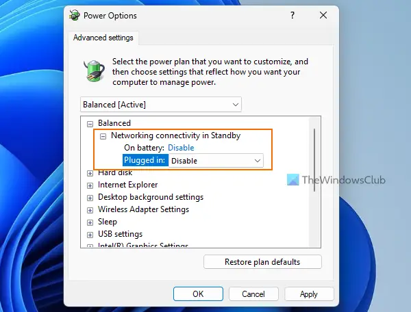

6] Disable Network connectivity in Standby
This solution helped one of the users with the same problem. Modern Standby systems support network connectivity in standby mode and if it is enabled when your laptop is asleep, the system will remain connected to WLAN or Wi-Fi to receive notifications, incoming calls, emails, etc. So, that could be one of the reasons for draining your laptop battery while it is in sleep mode. Therefore, you should disable network connectivity in Standby and see if this helps.
In the Power Options window, expand the Network connectivity in Standby section for your power plan, and select Disable option for the On battery mode and Plugged in mode. Press the OK button to save the changes. You can also disable the networking connectivity in Standby using Group Policy Editor, Registry Editor, and other ways.
