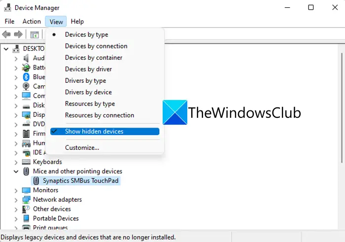

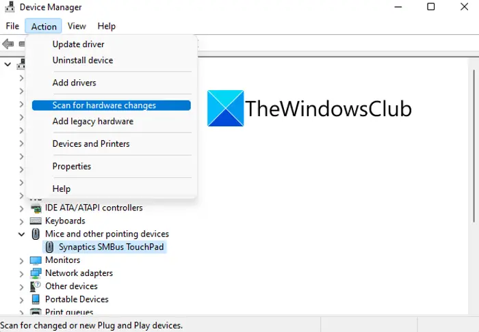

2] Show hidden devices in Device Manager
You might not be able to view certain devices, including the touchpad, by default. Or it might be that Windows has failed to detect the drivers for some specific devices. So, if the scenario is applicable, you should be to fix the issue using the Show hidden devices feature in Device Manager. See if you can view your touchpad device driver in Device Manager after enabling this feature.
Here are the steps to show hidden devices in Device Manager:
First, press Windows + X to open the shortcut menu, then select Device Manager.
Now, go to the View menu tab and choose the Show hidden devices option.
Next, navigate to the Action menu tab and click on the Scan for hardware changes option.
After that, reboot your PC to let the changes take place. On the next startup, check whether the issue is fixed.
If you are still unable to view the touchpad in Device Manager, try the next potential fix to resolve the issue.
