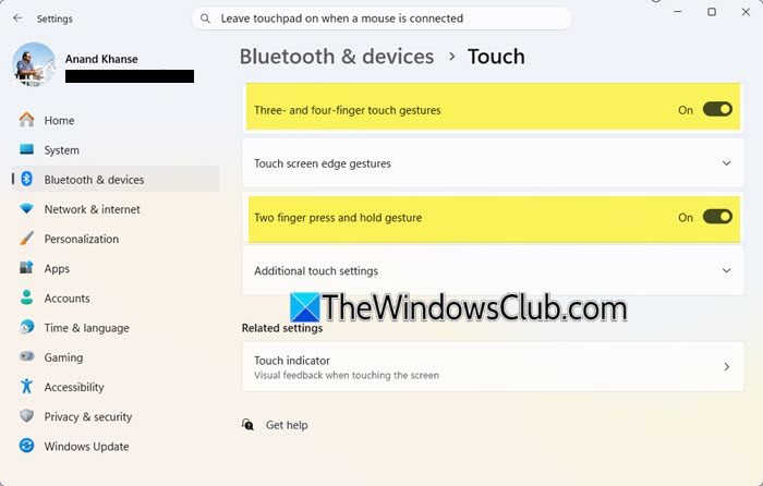

How to enable 2, 3 and 4 finger touch gestures in Windows 11?
Open Windows Settings > Bluetooth & devices > Touch and toggle On the following settings:
- Three and four finger touch gestures
- Two finger press and hold gestures.
Restart your PC.
