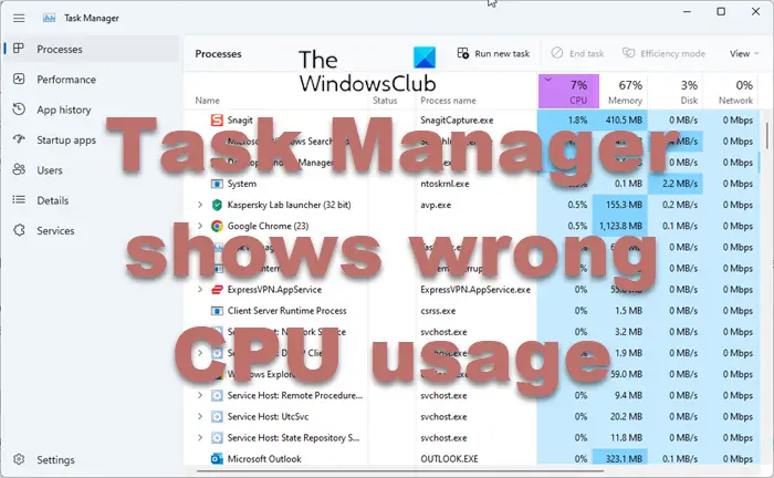

If your Task Manager shows wrong CPU usage on Windows 11/10, you must act fast. Users have reported this issue after updating a problematic program. When Task Manager shows incorrect CPU usage percentages, it can cause needless trouble for most Windows users, as the figures can mislead you. The issue isn’t widespread, but users have reported many cases on Windows 11 running on AMD processors. In whichever case, if it happens to you, you must fix these wrong CPU usage percentages in the Task Manager.
If your Task Manager displays wrong CPU usage figures on Windows 11/10 follow these suggestions to fix the issue:

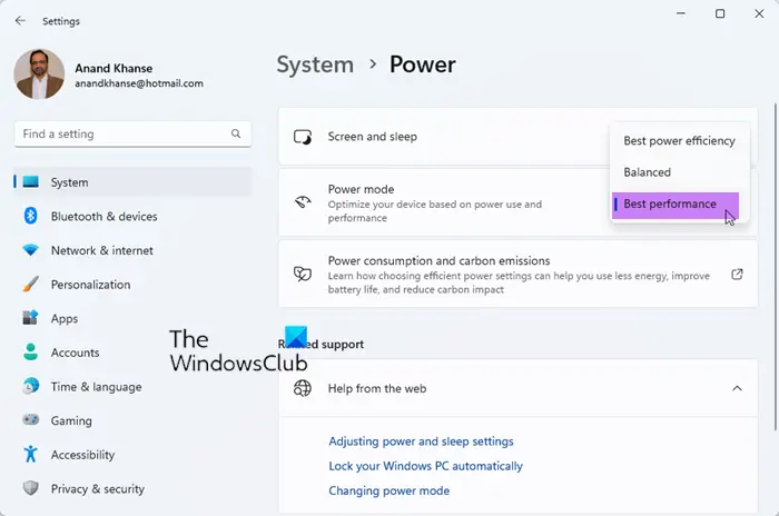

1] Change Power settings
You can tweak the power settings on your Windows PC and correct the problem. Here is how:
- Open the Settings by pressing Window Key + I.
- Now, select System and go ahead to choose Power & Battery.
- You will see a drop-down that is next to the Power mode.
- Hit on the Best performance from the list.
- The final step is to restart your Windows PC.
