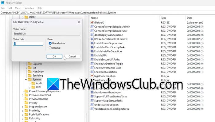

3] Enable LUA
Even though LUA (Limit User Account) controls the User Access Control (UAC) feature, due to a bug it can affect the mouse cursor as well. We have noticed that disabling it can make the cursor move unprecedentedly. To resolve the issue, we need to make sure that LUA is enabled in the registry, if not, we need to make some changes. Before we go ahead and make these changes, it’s recommended that we back up the registry, which can be used to restore it if required. Once done, follow the steps mentioned below.
- Open the Registry Editor by searching it out of the Start Menu.
- Then, go to
Computer\HKEY_LOCAL_MACHINE\SOFTWARE\Microsoft\Windows\CurrentVersion\Policies\System. - Look for EnableLUA, double-click on it, and set the Value data to 1.
Once done, reboot the computer and check if the issue is resolved. If it was already 1, change it to 0, reboot the system, switch it to 1, again restart the machine, and finally, check if the issue is resolved.
