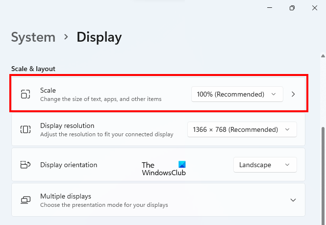

2] Scale your display to 100% (Recommended)
If you have set the display scaling to something other than what Microsoft recommends to its users, you may sometimes experience issues. The issue of the mouse cursor disappearing when playing games in full-screen mode may be related to display scaling. Check if you have set custom display scaling. If yes, change it to the recommended display scaling. In most cases, it is 100%. The steps for the same are provided below:
- Open Windows 11/10 Settings.
- Go to “System > Display.”
- Click on the drop-down next to Display and select 100% (Recommended).
