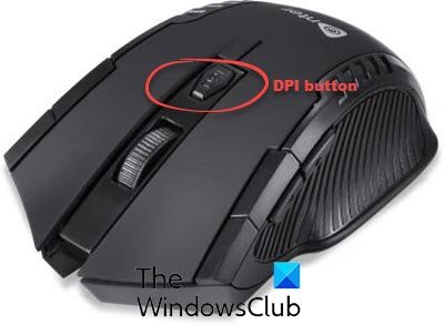

- Locate the DPI button on your mouse.
- Press and hold the DPI switch on your mouse for 5 to 7 seconds.
- Release the DPI switch.
This will turn Off the media mode and enable the normal mode of the mouse.
