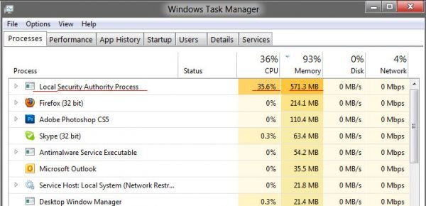

LSASS.exe or Local Security Authority Subsystem Service or Local Security Authority Process is a process on Windows operating system. It is valuable in enforcing the security policy on the computer. When a user logs in to the Windows Server, it is responsible for handling the password changes and creating the access tokens while updating the security log.
Is lsass.exe a virus?
Is lsass.exe a virus? the process is often targeted by malware and mimicked. The original location of this file is C:\Windows\System32 when C: is your system partition. So, if the process with a similar name is running on the Task Manager but the location is different, you know that the process is a threat and is exploiting the security on your computer.
In this article, we will be discussing the high resource consumption of the original lsass.exe on Windows.
Fix lsass.exe High CPU and Disk usage in Windows 11
If LSASS.exe or Local Security Authority Subsystem Service is displaying High CPU and Disk usage on Windows 11/10, follow these suggestions:
