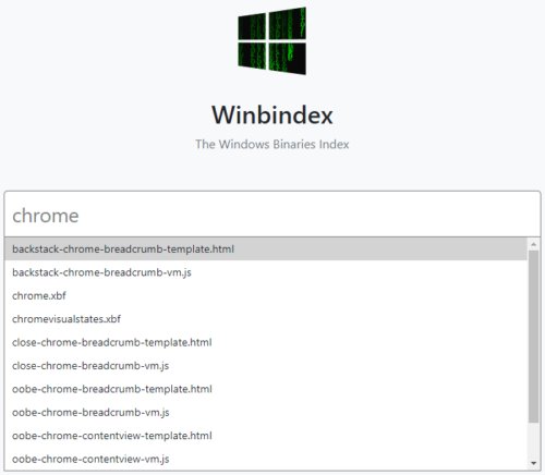

You may restore the file from Recycle Bin if you have accidentally deleted the dll file from your system. You can also restore this file by logging into another working Windows computer that has been recently updated, navigating to the C:\Windows\System32\ folder and locating, copying the file to a USB drive, then plugging the drive into the problematic PC, navigating to the exact folder, then paste the file in that location. Alternatively, a healthy copy of the DLL file can be downloaded from Winbindex – a new web service that allows users to see the information about Windows 11/10 OS files download them from Microsoft servers.

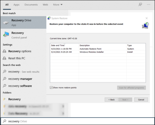

6] Perform System Restore
Your system might have undergone a change you are not aware of; considering that the system was working fine without issues recently. In this case, since you do not know what changed that might have broken the normal system functionality and consequently triggered this error, you can perform System Restore to revert your computer to a working state prior to the error occurring on your PC.

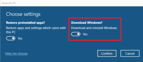

7] Perform Reset This PC, Cloud Reset or In-place Upgrade Repair Windows
At this point, you may be dealing with severe system corruption. In this case, to resolve the issue on your Windows 11/10 device, you can try Reset This PC, or Cloud Reset to reset every Windows component. If resetting didn’t help, you can perform an In-place Upgrade Repair to have the issue fixed.
