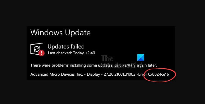

When installing an update on Windows, sometimes you may encounter the Update error code 0x8024ce16. It may prevent you from installing pending updates or cumulative updates. While this is an uncommon Windows Update error, we have listed some solutions to help you fix the issue.
What is Windows Update Error 0x8024ce16?
The Windows Update error 0x8024ce16 may occur while trying to install an update and is caused due to inconsistencies in the Windows Update database. Corrupted or incompatible device drivers are one of the primary reasons for this.

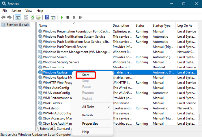

5] Restart the Windows Update service
In some cases, the Windows update error may occur if the related services like Windows Update, Windows Update Medic, Update Orchestrator Services, etc., are disabled. If yes, then make sure you enable all the services one by one.
For this, open the Windows Service Manager > right-click on each of the services below and click on Start or Restart to make sure they are all running:
- Windows Update
- DCOM Server Process Launcher
- RPC Endpoint Mapper
Also, double-click on the service to open its Properties window, and change the Startup type to Manual (Triggered) for the Windows Update service.
Next, change the Startup type to Automatic for the respective services below:
- Cryptographic Services
Now, change the Startup type to Manual for each of the services below:
- Windows Installer
- Windows Update Medic Services
- Background Intelligent Transfer Service
Also, make sure that you find the dependencies of the Windows Update services and check if they are running. If not, make sure you Start them.
