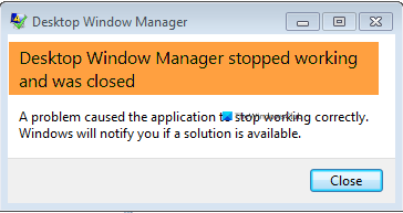

Some users have seen an error message on their Windows system stating – Desktop window manager stopped working and was closed. According to the users, DWM.exe crashes while performing specific tasks like playing a game, a video, while running a program, or even while doing any task related to Windows Explorer.

Desktop Window Manager stopped working and was closed

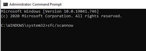

1] Run an SFC scan
Maybe the system file has become damaged. You can repair the damaged files by running the System File Checker tool. To run a complete SFC scan, follow these steps:
1] Click on Windows ‘Start’ and type ‘cmd’
2] Now, right-click on ‘Command Prompt’ and hit ‘Run as Administrator’
3] In the ‘Command Prompt’ window, type ‘sfc/scannow’
4] Hit ‘Enter’
Wait for the System File Checker tool to complete the process.

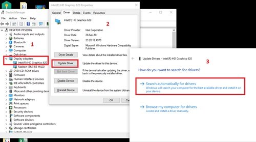

5] Update or Rollback Graphics card driver
Update your Graphics driver and see if it helps. If you recently updated your Graphics driver and then this problem started, then we suggest that you rollback the driver.
To update the driver:

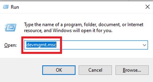

1] Press ‘Win + R’ keys to open the ‘Run’ dialog box.
2] In the ‘Run’ dialog, type ‘devmgmt.msc’
3] Hit ‘Enter’
4] In the ‘Device Manager’ windows locate ‘Display adapters’ and click on the arrow and expand it.
5] Double-click on your graphics card to launch its ‘Properties’ window.
6] In the graphic card ‘Properties’ window, click the ‘Driver’ tab.
7] Under the Driver tab, hit on ‘Update Driver’.
8] You will be prompted for options on ‘How do you want to search for drivers?’ click on ‘Search automatically for drivers’.
Windows will now search for any new updates available for your graphics card driver and install them. Once the process is completed. check if your issue is resolved.

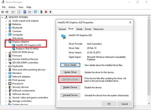

To rollback the driver:
3] Hit ‘Enter’
7] On the ‘Driver’ tab there would be a button named ‘Roll Back Driver’. If there are any recent updates installed, then this button would be active. Click on the ‘Roll Back Driver’ button.
Wait for the update to be rolled back, and restart the system and check if the issue persists. If the button is not active, please move on to the next method.
