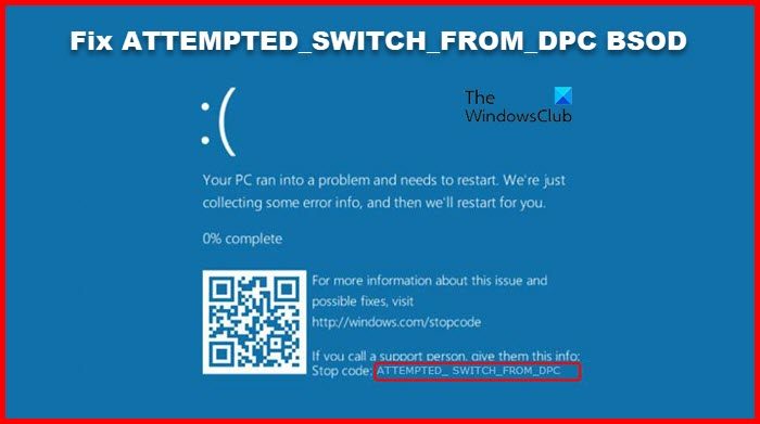

Some users have reported that their system automatically shut down during the initialization process after displaying a ATTEMPTED_SWITCH_FROM_DPC Blue Screen. However, in some cases, the Blue Screen of Death appears while using the computer. In this article, we will discuss the issue and explore how to resolve it.
The ATTEMPTED_SWITCH_FROM_DPC bug check has a value of 0x000000B8. This indicates that an illegal operation was attempted by a delayed procedure call (DPC) routine.
ATTEMPTED SWITCH FROM DPC Blue Screen on Windows 11
Usually, the error code in question is caused when your computer shutdown during the booting step. DPC or Delayed Procedure Call triggers the error code and states that this is an illegal operation. There are various reasons for this to have happened, and outdated drivers stand as the most common one. The BSOD can also be caused due to ntoskrnl.exe crashing. We have mentioned solutions that will help you in fixing this issue.

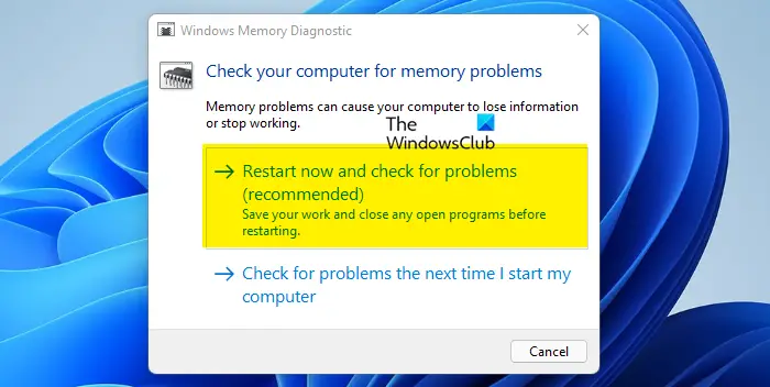

4] Run Memory Diagnostic
If there is an issue with your memory software. Microsoft acknowledges that the memory device is vulnerable and can experience such issues. That is why they have included a diagnostic tool that can do the job for you. Follow the given steps to run Memory Diagnostic.
- Open Windows Memory Diagnostic from the Start Menu.
- Select Restart now and check for problems (recommended).
- Your computer will restart and do its job.
Hopefully, this will do the trick for you.
