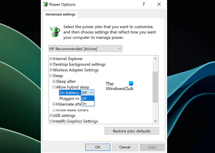

4] Disable Hybrid Sleep (if applicable)
Check if Hybrid Sleep is activated on your computer. If yes, disable it.
