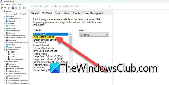

6] Do not auto disable Gigabit
There is an option in Realtek PCIe GBE Family Controller, Auto Disable Gigabit, to save energy. If enabled, your system will detect when the network is idle and turn off ethernet functionality. However, it can sometimes cause issues such as the one in question. That is why we are going to disable it using the following steps.
- Open the Device Manager.
- Expand Network adapters, right-click on Realtek PCIe GBE Family Controller, and select Properties.
- Go to the Advanced tab, look for Auto Disable Gigabit, and set it to Disabled.
Finally, we need to flush DNS. To do that, open the Command Prompt as an admin and run ipconfig /flushdns.
