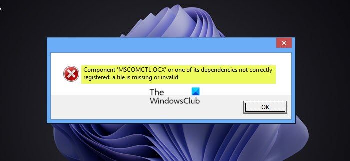

When you encounter this issue, you’ll receive the following full error message;
Component ‘MSCOMCTL.OCX’ or one of its dependencies not registered: a file is missing or invalid

If a program prompts you with the MSCOMCTL.OCX file is missing or invalid error on your Windows 11/10 device when you try to install or launch the software on your computer, it simply means the app cannot find the required OCX file in the appropriate system directory or the OCX file isn’t correctly registered on the computer.
MSCOMCTL.OCX or one of its dependencies not registered

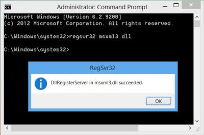

2] Re-register .OCX file
When this error occurs, it means that the required file for the software isn’t registered or is missing, and the application in question won’t be able to run on your system. Registering a file with the Windows 11/10 operating system means that the OS stores the entry of the file in its database and knows it is present in that specific directory. This file can be used by any application that requires it and calls it.
This solution requires you to re-register the .OCX file in question. Here’s how:
- In the Run dialog box, type cmd and then press CTRL + SHIFT + ENTER to open Command Prompt in admin/elevated mode.
- In the command prompt window, depending on your system architecture, type the command below and hit Enter:
For 64-bit system
regsvr32 "C:\Windows\SysWOW64\MSCOMCTL.OCX"
For 32-bit system
regsvr32 "C:\Windows\System32\MSCOMCTL.OCX"
Note: If C:\ is not your system (Windows installation) drive letter, change it accordingly.

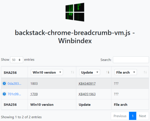

You can restore the MSCOMCTL.OCX file to the appropriate folder with a healthy copy of the file (if available) from Winbindex – a new web service that allows users to see the information about Windows OS files download them from Microsoft servers.
