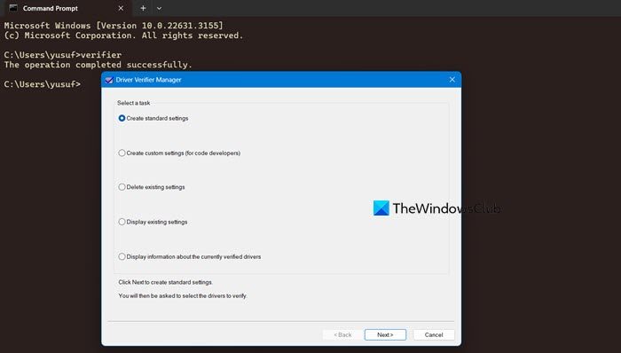

How do I use driver verification in Windows 10?
We can pretty easily open the Driver Verification utility in Windows 11 or 10 using the Command Prompt. So, open Command Prompt and run “verifier”. This will open the Driver Verifier Manager for you.
