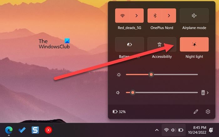

1] Check if Night Light is on
The very first thing you need to do is check if the Night Light is on as it casts a slightly reddish-yellow shadow on your screen to protect your eyes from blue light coming out of the monitor screen. To do the same, you can either go to Quick Settings by clicking the battery icon (or some other icon on your taskbar) or go to Settings > System > Display and check if the Nigh Light is on. In case, the Night light is on, you can turn it off or configure its settings to make it slightly better.
If you want to configure the settings, go to Settings > System > Display > Night Light, then change the Strength or Color Temperature. The warmer the display is, the reddish it will get. So, keep this information in mind when changing the display temperature.
