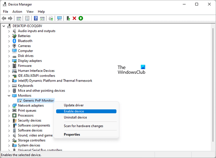

3] Make sure that the Generic PnP Monitor driver is enabled
The Generic PnP driver tells the Windows operating system about the monitor connected to your computer. It is installed on both laptops and desktops. It is responsible for controlling the brightness of your display. If you disable this driver, you will not be able to change your screen brightness. Even moving the screen brightness control slider in Settings will not work after disabling this driver. Such an issue also occurs if this driver gets corrupted.
Check if this driver is enabled or not. Follow the steps written below:
- Open the Device Manager.
- Expand the Monitors branch.
- Right-click on the driver and click Enable device. The Enable device option is available only if the driver is disabled.
After enabling the Monitor driver, the problem should be fixed. If the Generic PnP Monitor driver shows a yellow warning sign, the problem is with your Monitor driver. Maybe it is corrupted. In this case, uninstalling and reinstalling the driver will help. Right-click on the Monitor driver and select Uninstall device. After uninstalling the driver, restart your computer. Windows will automatically detect the hardware changes when you restart your computer and install the missing driver.

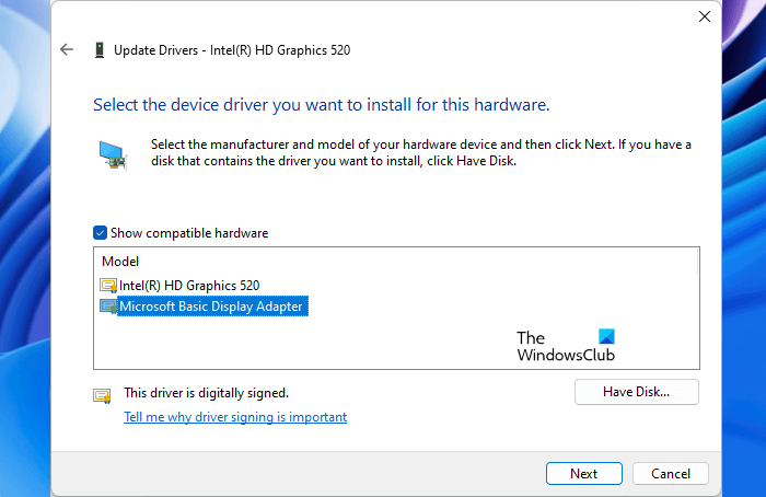

7] Install Microsoft Basic Display Adapter
Installing the Microsoft Basic Display Adapter has helped many users. Hence, it should also work for you. Go through the following instructions:
- Expand the Display adapters branch.
- Right-click on your display driver and click Update driver.
- Click Browse my computer for drivers.
- Now, click Let me pick from a list of available drivers on my computer.
- Select Microsoft Basic Display Adapter.
- Click Next and follow the on-screen instructions to install the driver.
