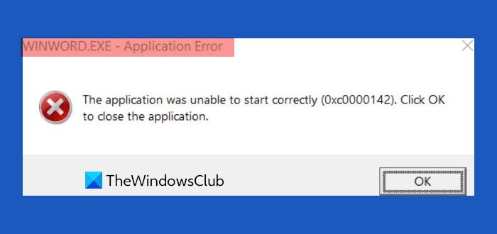

WINWORD.EXE is the Microsoft Word process listed in the Task Manager. Other Office applications may also rely on the WINWORD.EXE process. Sometimes Windows 11/10 displays error messages regarding corrupted or missing WINWORD.EXE file. Corrupted or nonexistent WINWORD.EXE file can, therefore, result in a failed execution of the started process.
The word WINWORD stands for Microsoft Word. However, you can encounter this error when you try to access/open other Office applications like Excel, PowerPoint, Outlook, etc.
WINWORD.EXE error can occur due to several reasons:

These error messages sometimes are accompanied by error code(s) like 0xc0000142, 0xc0000005, 0xc00007b, 0xc00000715, etc. Nevertheless, whichever of the error you experience, the fix is essentially the same.
Fix WINWORD.EXE application error in Word on Windows 11/10
To fix WINWORD.EXE application error, Unable to start correctly with code 0xc0000142, 0xc0000005, 0xc00007b, 0xc00000715, etc. on Windows 11/10 you can follow these suggestions.
