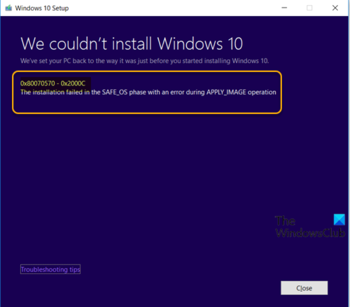

Some users are encountering the upgrade error 0x80070570 – 0x2000C while upgrading to Windows 11 – or when installing Windows 11 Feature Upgrades. This post offers the most suitable solutions you can try to successfully resolve this issue.
When you encounter this issue, you’ll receive the following full error message;
We couldn’t install Windows 11/10
We’ve set your PC back to the way it was just before you started installing Windows.
The installation failed in the SAFE_OS phase with an error during APPLY_IMAGE operation.
Error code 0x80070570, ERROR_FILE_CORRUPT indicates that the OS files could have become corrupted.
Fix Windows Upgrade error 0x80070570 – 0x2000C
