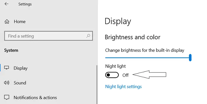

6] Disable Night light mode and Game Bar
Folks have reported that disabling Night light mode and Game Bar has helped them. Try it and see.
Open your Windows settings and select System. From the Display settings, toggle the Night Light option off if you have it enabled.
Similarly, in order to turn Game Bar off, visit the settings homepage and select Gaming.
From there, in Xbox Game Bar, you’ll see the option to disable it upfront. Toggle it off, close settings, and check if the issue has been resolved.
