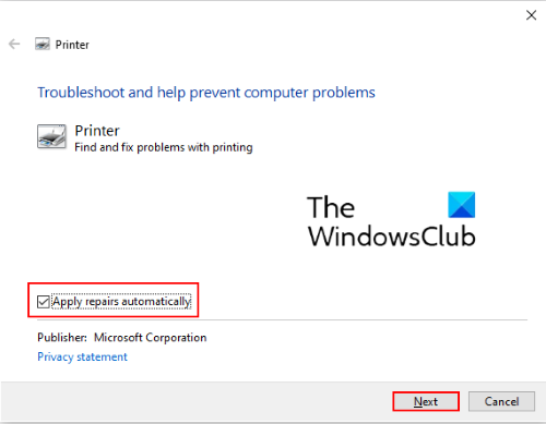

1] Run the Printer Troubleshooter
Printer Troubleshooter is a built-in Windows 11/10 tool that helps users solve different types of printer errors.
To run the Printer Troubleshooter, open the Get Help app. You can find it in the Start Menu, or you can use the Taskbar search box. In that case, search for get help in the Taskbar search box and click on the search result to open the app on your computer.
Next, you need to open the troubleshooting page by searching for Run the Windows Printer troubleshooter.
