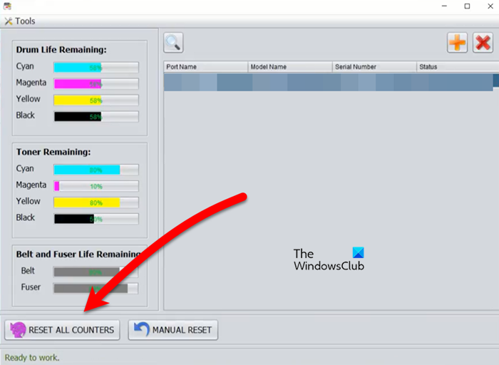

7] Reset OKI Printers
To reset an OKI Printer, use the Printer Menu setup tool that comes with your printer. So, open the app and attach your printer, then click RESET ALL COUNTERS. Finally, follow the on-screen instructions to reset your printer. If you want to manually, reset the Printer, select MANUAL RESET > FACTORY DEFAULT. And you will be good to go.
